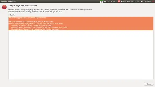

Now when I try to upgrade, I get this:
E: Could not get lock /var/lib/dpkg/lock - open (11: Resource temporarily unavailable)
E: Unable to lock the administration directory (/var/lib/dpkg/), is another process using it?
masoud@masoud-PC:~$ sudo apt-get upgrade
and when I use: sudo dpkg --configure -a
I get this:
dpkg: error: cannot scan updates directory `/var/lib/dpkg/updates/': No such file or directory
and for sudo apt-get upgrade -f get:
Reading package lists... Done
Building dependency tree
Correcting dependencies... failed.
The following packages have unmet dependencies:
 ia32-libs : Depends: ia32-libs-multiarch but it is not installable
 wine1.4 : Depends: wine1.4-i386 (= 1.4.1-0ubuntu5) but it is not installable
E: Error, pkgProblemResolver::Resolve generated breaks, this may be caused by held packages.
E: Unable to correct dependencies
