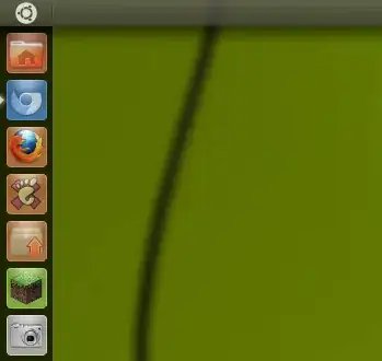

There is an awesome Minecraft installation script for Ubuntu that will solve all your problems. Here is the link --> http://www.ubuntuvibes.com/2011/04/minecraft-installation-script-updated.html
This will create a Minecraft shortcut icon in actual menu under games. So you need to just launch Minecraft, right click the icon and select 'Keep in Launcher'.
I have done the same thing and it's working nicely. Here a screenshot:
Minecraft
