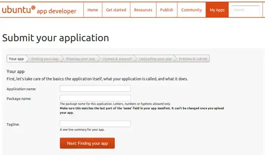

DO NOT click on the My Apps tab at http://developer.ubuntu.com. This is the old application submission method.
Go to https://myapps.developer.ubuntu.com/dev/click-apps/new/. This is the new app store for Ubuntu Touch. It should look like this:
Click App Store Submission Form
