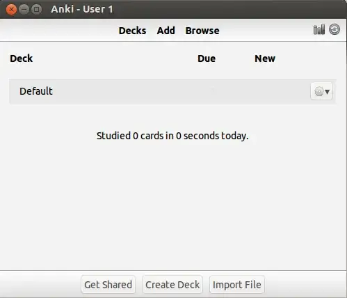

This was my output when running the files. Notice how in the second block, apt-get is installing the unmet dependencies, one of which is python-sqlalchemy as noted in the other answer. Afterwards, anki works fine.
