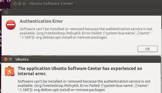

aptitude is not installed, and when I start Ubuntu Software Center it tells me New software can't be installed, because there is a problem with the software currently installed. Do you want to repair this problem now?, when I click Repair an internal error appears:
