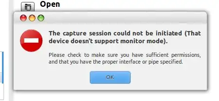

I need to sniff all the wifi traffic that I can capture using wireshark in Ubuntu. My wireless interface is named as eth1 in the interfaces list. When I select that interface in Wireshark and start new sniff, I got following error;

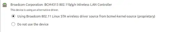

I have installed a broadcom wireless driver in Additional Drivers as follows:

Finally I found a solution by little research. The problem was really with the device driver I had chosen in Additional Drivers as the image shows in the question. I then selected the second choise in wireless drivers which is "Do not use this device". It doesn't have the meaning it implies, it only does avoid using broadcom wireless STA driver. Then I restarted my machine and I could see my interface as wlan0 (which was previously displayed as eth1).

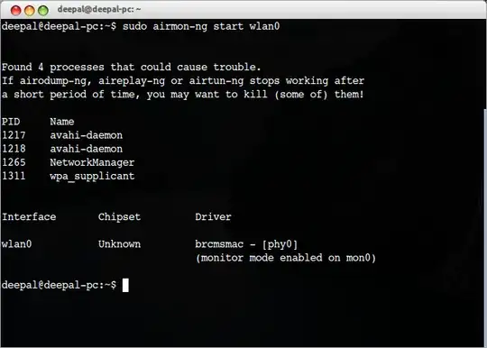

Then I executed following command (airmon-ng bash script), which I could easily turn wireless card into monitor mode.
sudo airmon-ng start wlan0
It was required to start monitoring mode of the wlan0 interface using airmon-ng script before sniffing. Otherwise when I start a sniff using wlan0 with wireshark(monitor mode enabled in wireshark) I could only sniff few seconds and automatically device disconnects from the network.
