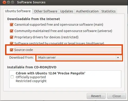

1) Make sure you have enable the Source code repository
  • Open Ubuntu Software Center.
  • In the Menu Bar choose Edit -> Software Sources. Click to enable "Source code repository".
  • Just in case I use the "Main Server" to Download.

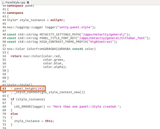

6) Edit the the files "PanelStyle.cpp" & "PanelIndicatorEntryView.cpp"
  • gedit unity-5.20.0/plugins/unityshell/src/PanelStyle.cpp
Search for the line "63" and change it.
eg:(In my case I changed it from 24 to 42)
Before:
: panel_height(24)
After:
: panel_height(42)

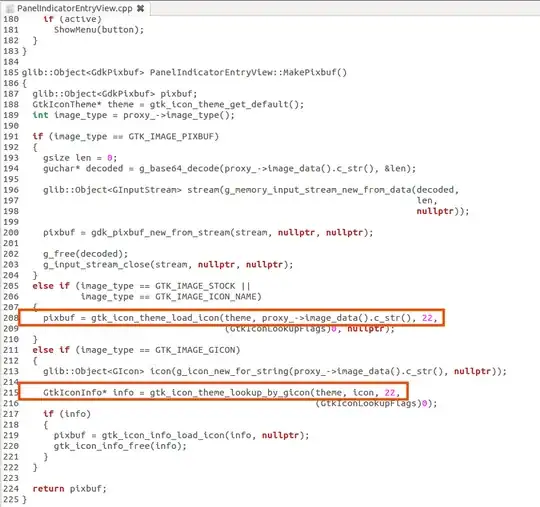

  • gedit unity-5.20.0/plugins/unityshell/src/PanelIndicatorEntryView.cpp
Search for the lines "208" & "215" and change them.
eg: (In my case I changed them from 22 to 24)
Before:
pixbuf = gtk_icon_theme_load_icon(theme, proxy_->image_data().c_str(), 22,
GtkIconInfo* info = gtk_icon_theme_lookup_by_gicon(theme, icon, 22,
After:
pixbuf = gtk_icon_theme_load_icon(theme, proxy_->image_data().c_str(), 24,
GtkIconInfo* info = gtk_icon_theme_lookup_by_gicon(theme, icon, 24,

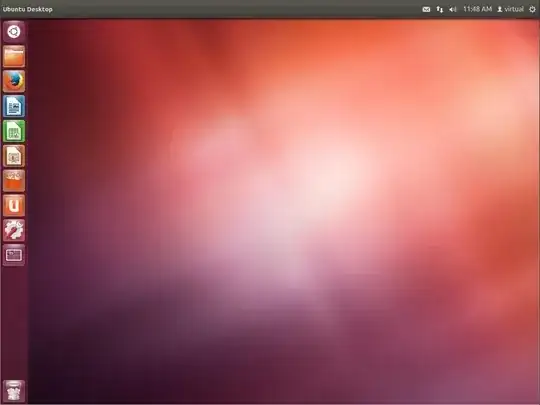

Before:

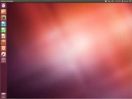

After:
