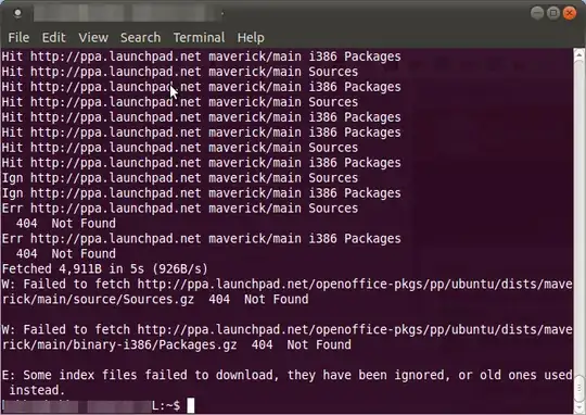

sudo apt-get update command always gives me errors. It's been days since my package lists have been updated. Can anyone help me to correct it? Here is the Screenshot:
Here are the commands and their ouputs:

It looks like a spelling error in you sources.list. Apt should be fetching
http://ppa.launchpad.net/openoffice-pkgs/ppa/ubuntu/dists/maverick/main/binary-i386/*
, but you are missing the a in /ppa/
Update after you posted sources.list:
deb http://ppa.launchpad.net/openoffice-pkgs/pp/ubuntu maverick main
should be
deb http://ppa.launchpad.net/openoffice-pkgs/ppa/ubuntu maverick main
And ditto for deb-src
Update 2: Actually, you appear to have both the correct spelling and an errornous spelling, so you should just remove the lines with the missing a's.
