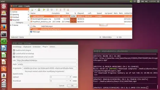

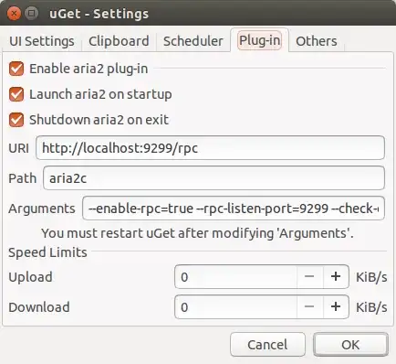

I have my own answer in uGet 1.10.4 in Ubuntu 14.04 with aria2c version 1.18:
  1. You must specify your own RPC port. In my example, 9299. This port number is must not being used by another process.
  2. Then you should add --enable-rpc=true --rpc-listen-port=9299 to the arguments.
  3. You may specify additional argument such as --check=certificate=false.
To proof this, I ran uGet via console. Then I can see any output from aria2 in my console.
Result
It works. uGet and aria2 finally work together. I've been waiting for ~3 months for this.

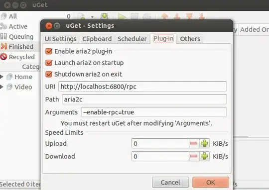

My solution to exact same issue was this:
In UGet settings under plug-in tab change argument to this: --enable-rpc=true
Then restart Uget and aria2 should be working. Uget version I use is 1.10.3.
Screnshot UGet settings for aria2
