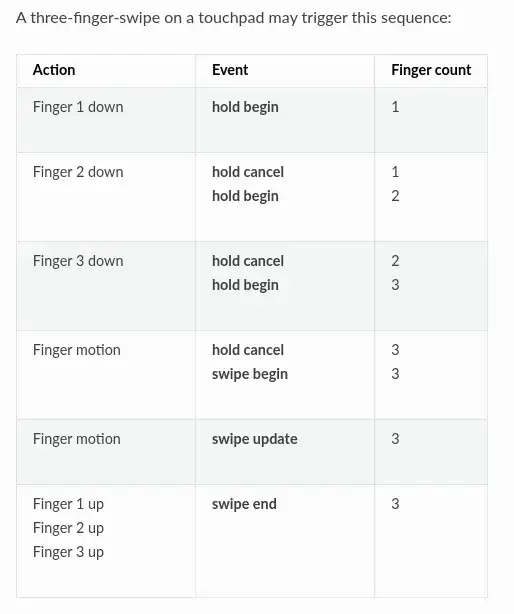

You can build https://wayland.freedesktop.org/libinput/doc/latest/building.html Ubuntu and has some cool features. It also has 3 finger gesture. You can configure it to do drag. Here https://wayland.freedesktop.org/libinput/doc/latest/gestures.html. I am using it for Gnome Xorg in Ubuntu 20.04.enter image description here. I am also trying to have the same 3 finger drag using Trackpad 2. By the way, libinput is smoother like in Macs than Touchegg. I'll share my knowledge here while I go.
