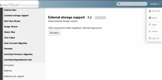

For allowing the use of a personalized storage media, you need the External Storage module enabled in your Apps.

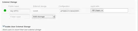

Once you have enabled this module, you will have new options in the Admin page called External Storage. Configure the Folder name, the type (if it's Local, Google Drive, WebDAV, etc.), the configuration (in the case of a Local, the target directory) and the users with access.

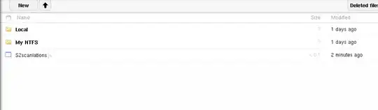

Once you have ended, you can go to the main screen and you will find a directory with the name of the resource.
