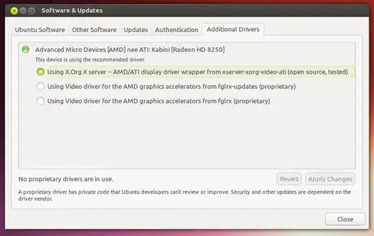

Also I saw this and: https://wiki.ubuntu.com/X/HybridGraphics
kerem@kerem:~$ dpkg -l fglrx\*
Desired=Unknown/Install/Remove/Purge/Hold
| Status=Not/Inst/Conf-files/Unpacked/halF-conf/Half-inst/trig-aWait/Trig-pend
|/ Err?=(none)/Reinst-required (Status,Err: uppercase=bad)
||/ Name           Version      Architecture Description
un  fglrx-glx      <none>                    (no description available)
Kerem
  • 696
You need to install Catalyst.
For your card and kernel, you want 13.6.
Follow these directions exactly, and you should be good to go.
