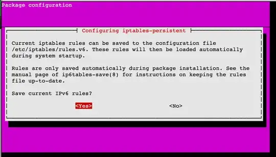

I'm trying to build an Ansible Playbook to deploy some Ubuntu 12.04 servers on Linode, but my problem seems to be an Ubuntu one. When I run different combinations of apt-get or aptitude I always get the following dialog that I have to respond to.
Package configuration dialog
I'd like this to be answered from the command line so that it doesn't interrupt the automatic deployment. Any ideas?

Try using debconf-set-selections to set the value before installing the package:
echo iptables-persistent iptables-persistent/autosave_v4 boolean true | sudo debconf-set-selections
echo iptables-persistent iptables-persistent/autosave_v6 boolean true | sudo debconf-set-selections

You missed -q. Try:
sudo DEBIAN_FRONTEND=noninteractive aptitude install -y -q iptables-persistent
