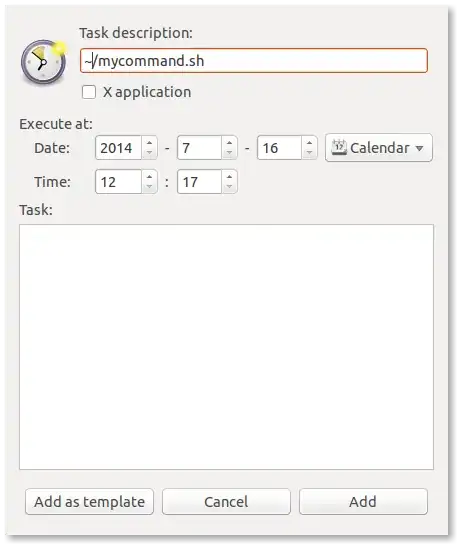

Using gnome-schedule, for a script in your home directory, a new "at" command would be set up using this type of window:
