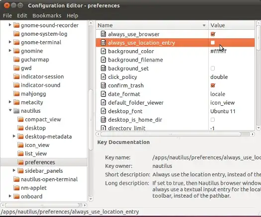

To default Breadcrumbs view in Nautilus open gconf-editor, go to apps -> nautilus -> preferences and untick always_use_location_entry:
