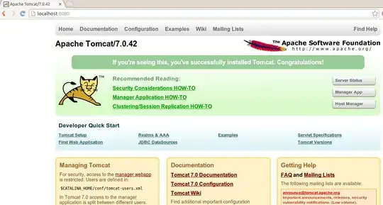

You're done. Point your browser to http://localhost:8080 and you should see the Tomcat page:
