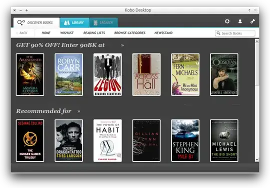

A Kobo Desktop launcher should now appear in the dash. Clicking it will launch the application :
