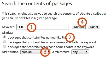

How did I find this? Use the search on paths on the http://packages.ubuntu.com site:
