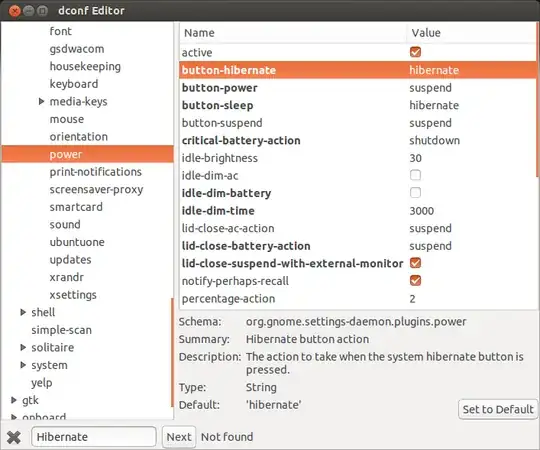

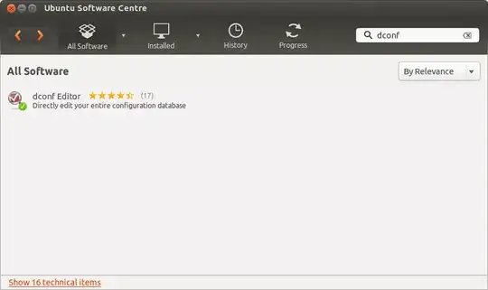

If you have not already found it, download and install dconf Editor from the Ubuntu Software Center
  1. Start the programme
  2. Click Ctrl + F to activate the search facility
  3. Type in Hibernate and click the Next button
  4. Make sure that the value for Hibernate is set to Hibernate, not inactive.
You're done.
