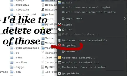

I read the explanation to add a Custom Action, and how to remove them. But I'd like to remove the "delete" custom Action to keep only those I want.
Is it possible to Remove defaults custom actions, or to select them or do we have to keep some Custom Actions like "Delete" or others ?
Thunar image
And if yes, how can we manage ?

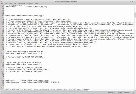

5) Edit the the file "thunar-standard-view.c"
  • mousepad thunar-1.6.2/thunar/thunar-standard-view.c

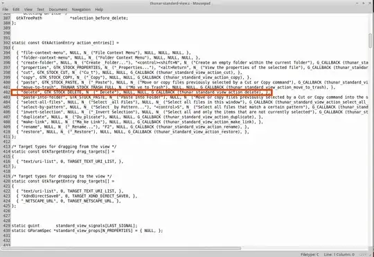

You should remove the line number "402" and save the changes.
{ "delete", GTK_STOCK_DELETE, N_ ("_Delete"), NULL, NULL, G_CALLBACK (thunar_standard_view_action_delete), },

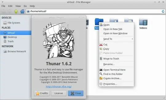

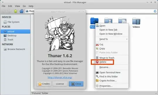

Before: enter image description here
After: enter image description here

9) Your thunar file manager should look like this:
(without the "Delete" Action")
