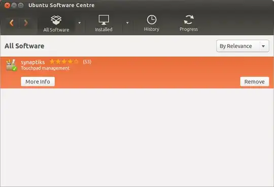

I had a similar problem. The way I corrected it was to install Synaptiks from the Ubuntu Software Center. Synaptiks
This gave me all the options which you are looking for.
