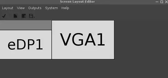

Do you have a configuration similar to:
If yes, according to this thread that is what confuses tint2. So the idea is the have the first dipsplay positioned in the topleft corner and everything should be fine. Like:
Note: The application in the screenshots is called arandr and it is responsible for writing xrandr configuration files.
