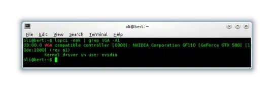

This is the simple bit. You should be looking at something like the following:
You can either type the command, or you can copy it (select the text, right click, "Copy", then right click the terminal, "Paste"). Copy & Paste is recommended for long commands. We want to avoid errors in transcription!
When you have typed or pasted the command into this window, press Return. Output should now appear on the screen as below:
Step 3: Copying the content
Copying is similar to most other applications apart from most consoles only know how to copy "blocks". To copy, simply use your mouse to drag around the output until it is highlighted, like so:
Right click on the terminal (to go to the Edit menu) and select "Copy". Then you can go back to your browser or editor and paste. We're done.

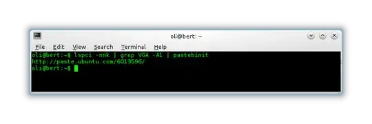

Then we run our command, followed by | pastebinit:
lspci -nnk | grep VGA -A1 | pastebinit
And you'll see something like the following (though obviously not in a window):
Write down the URL and you can share that with whomever you like.
