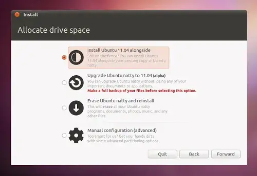

If the update manager doesn't work you can use a live usb/cd of Ubuntu 13.04.
You can simply make one using UNetBootin
After creating the live usb/cd boot it and start the installation process. You'll be prompted if you want to upgrade, install side by side or do a clean install. Click upgrade. instal promt
If you do not have your home folder on a separate partition you may want to back it up before doing this!
