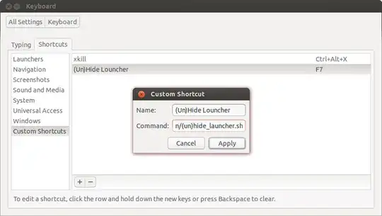

To set a (shortcut) key to run this script, go to System Settings...Keyboard, select Shortcuts tab and click + sign to add a new custom shortcut key. For "Name" field add whatever you wish; for "Command" add the path to the script:
Custom Shortcut
Then click where is written "Disabled" to add a new accelerator and press your key combination (I chose F7).

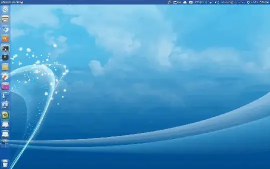

The result:
(un)hide launcher [Click to enlarge]
