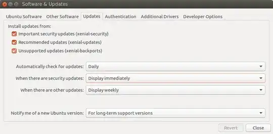

It is because, in Ubuntu 16.04 when there are security updates available for it, it automatically downloads and install them without notifying the user.
To disable this functionality you can visit Software & Update and under Update tab, change when there are security updates to Display immediately.

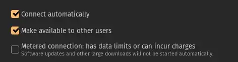

Update
Looks like you can set metered connections:
