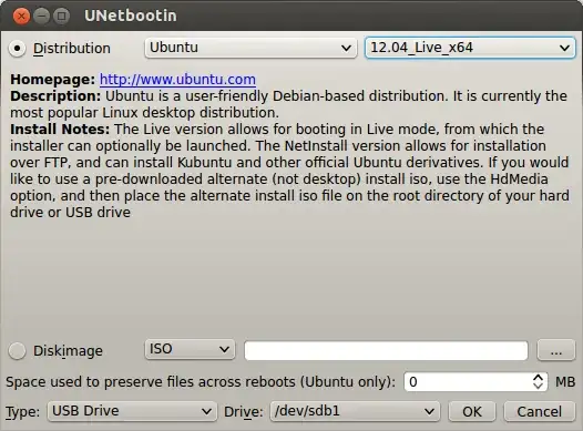

A user-friendly solution is UNetbootin, which works on Windows, Linux and MacOS and provides a graphical user interface which even downloads the Ubuntu image for you and writes it directly onto your flash drive:
Screenshot of UNetbootin
