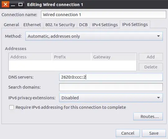

The third way would be to use IPv6 DNS. For instance, click on network indicator in top panel, select Edit Connections, and for your specific wifi or ethernet connection, use 2620:0:ccc::2 dns, which OpenDNS IPv6 server. Make sure you select "Address only" option
