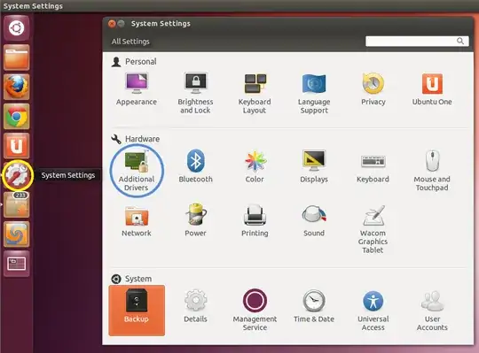

Open the unity search menu (the button at the top left corner) and search for "drivers" and you will find a driver program that will search for all the drivers required for the hardware in your PC. (The icon for this program looks like an PCI E device (such as a graphics card or sound card)
Go to your System Settings in the Unity launcher or at the right top corner of the screen and then go to Additional Drivers section.
From there you will be able to install a driver if it is displayed.
