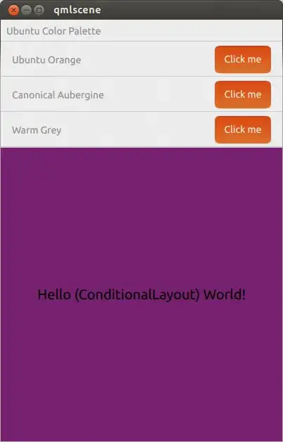

When in the default phone-like size, it looks like:
phone layout

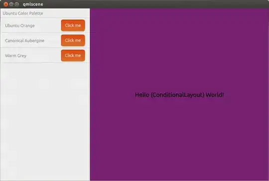

When it is expanded to a tablet or desktop-like size, it looks like:
tablet layout
I think that you can have this result using Conditional Layouts.
