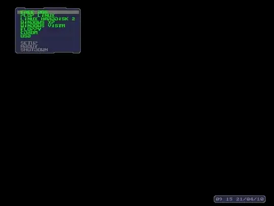

Your laptop is too old, and doesn't include an option to boot from the USB. There are alternatives that you can use to do this:
- Burn a CD/DVD. There is already several guides about how to do this.
- Use the Plop boot manager. http://www.plop.at/en/bootmanager/mbrinstall.html#wininst
- Install GRUB2DOS (this is not recomended due the lack of documentation)
- Install from the network
So, lets use Plop:
- Download the current boot manager plpbt-5.0.14.zip.
- Extract the zip file. Open the folder Windows.
- You will find the batch program InstallToMBR. Run it as administrator in VISTA/WIN7 (right mouse click on the file and choose "Run as administrator").
- The batch creates an entry in your windows boot menu called "Install the Plop Boot Manager to the MBR".
- Reboot and select the "Install the Plop Boot Manager to the MBR", reboot again.
- Once this is done, you will have a menu similar to the above image, as you can read the last option is USB. Select it and follow the in-screen instructions.
