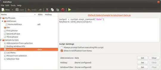

  • it has a predefined shortcut "adr" which should write an address after hitting space
  • and a shortcut "date" which should write the current date (after hitting tab)
Screenshot of settings in AutoKey
Problem
  • no matter what I define, "adr" or "date" it always inserts as much blank lines as the template uses
Example:
  • "date" should autocomplete after pressing space to "13/08/01" but it inserts one empty line
  • "adr" should do my full address but it inserts 4 empty lines

Solution for me (running Xubuntu 14.04) was to provide a .service file in/usr/share/dbus-1/services.
  • First I deleted all the example files and scripts, and created a new file. (This was on a fresh install of AutoKey.)
  • Then I created an empty file org.autokey.Service under /usr/share/dbus-1/services
  • In the org.autokey.Service file I put the following text:
    [D-BUS Service]
    Name=org.autokey.Service
    Exec=/usr/bin/autokey</code>
  • Then I killed AutoKey via the taskmanager (AK already hang), and restarted AutoKey
  • Tested it, and it works. No more blank lines. Text gets replaced like it should.
