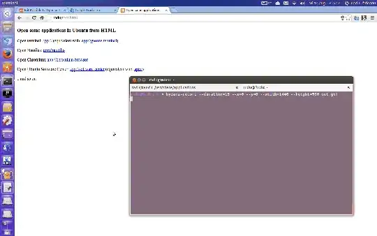

4. Test from browser using HTML
You can test from browser by using for example the following HTML web page:
<!DOCTYPE html PUBLIC "-//W3C//DTD XHTML 1.0 Strict//EN"
    "http://www.w3.org/TR/xhtml1/DTD/xhtml1-strict.dtd">
<html xmlns="http://www.w3.org/1999/xhtml" xml:lang="en" lang="en">
<head>
    <title>Open some applications</title>
    <meta http-equiv="content-type" content="text/html;charset=utf-8" />
</head>
<body>
        <h3>Open some applications in Ubuntu from HTML</h3>
        <p>Open terminal: <a title="Open" href="app://">app://</a>
        (equivalent with: <a title="Open" href="app://gnome-terminal">app://gnome-terminal</a>)</p>
        <p>Open Nautilus: <a title="Open" href="app://nautilus">app://nautilus</a></p>
        <p>Open Chromium: <a title="Open" href="app://chromium-browser">app://chromium-browser</a></p>
        <p>Open Ubuntu Software Center: <a title="Open" href="app://software-center">app://software-center</a>
        (equivalent with: <a title="Open" href="apt://">apt://</a>)</p>
        <p>...and so on</p>
</body>
</html>
The result:
