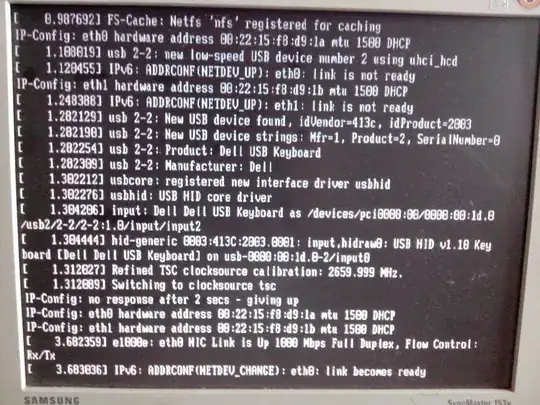

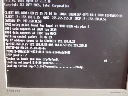

When I boot sms04 using the first network card, it can successfully get the IP 192.168.0.25 (static ip) and then load vmlinuz and initrd.
And then it failed with message IP-Config: no response after * secs - give up
Now, I try to pull out the cable in my first network card and plug in the second, after a while, it successfully boot up with dynamic IP address 192.168.0.21!
However, the dynamic IP address is unwanted. I try every method to boot from static IP, by failed.
I will appreciate any reply.
Simon
  • 4,843
I have spent a lot of time in this problem. So today I fixed it. Try to edit /etc/initramfs-tools/initramfs.conf and change: DEVICE= to DEVICE=eth0
