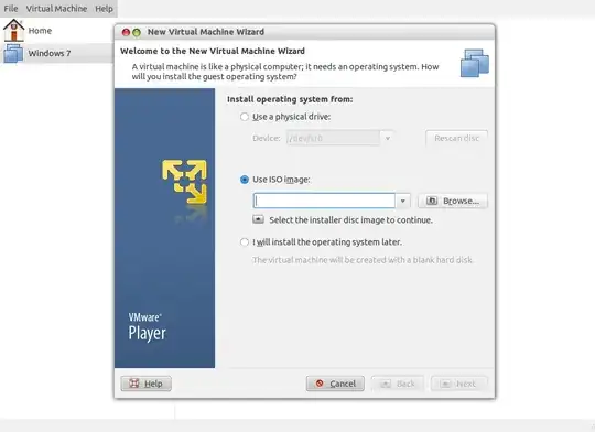

  3. The following window will open:
Select "Use a physical drive" if you want to install Windows from a DVD or select "Use ISO image" if you have an image of a Windows installation disk.
In the next few steps you can tweak the Virtual Machine and set things such as how much storage space the Virtual Machine can use and how much memory. After that you'll need to power-on the Virtual Machine and complete the Windows installation.
