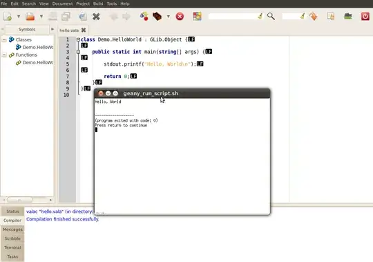

As @aperson said, Geany is a very good text editor - It is lightweight with lots of features. It also supports vala (you need to install valac first though for full vala features). A lot of its features are IDE like eg. you can build/run with 1 click.
geany vala
To install, run sudo apt-get install valac geany or search for 'valac' and 'geany' in Ubuntu Software Centre.

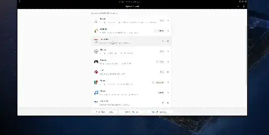

Surprised no one has mentioned Gnome Builder.
Upon opening the IDE, you can see the kinds of projects it supports (which also includes ones written in Vala):
