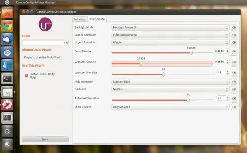

For 11.10 and 12.04
There's an option to do this in ccsm:
Screenshot of ccsm with launcher opacity setting
(Source)
