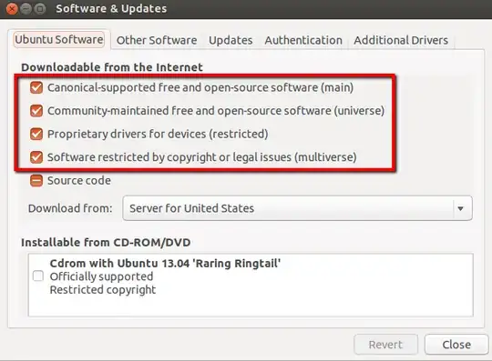

Make sure that the multiverse and universe repositories are enabled.
And then, just press Ctrl+Alt+T on your keyboard to open Terminal. When it opens, run the command(s) below:
sudo apt-get install ndisgtk
Source for command:Ubuntu Help
