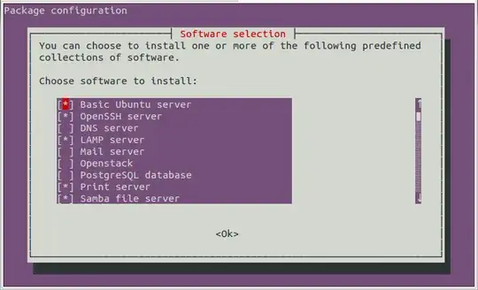

Note: as stated in comments, tasksel should only be used to install tasks, not remove them. In this specific task (remove desktop -> install server) it seems to work fine. So use it with caution.
You can try tasksel. With it, you can do what you want by selecting Basic Ubuntu Server and unchecking Ubuntu desktop.
sudo apt-get install tasksel
tasksel screen
