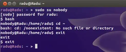

Also I noticed that I can login in this account from terminal using the following command and my password:
sudo su nobody
su nobody

Why I can't access this account with su nobody?
sudo grep nobody /etc/shadow will show you that nobody doesn't have a password and you can't su without an account password. The cleanest way is to sudo su nobody instead. That'll leave you in a pretty desolate sh shell.
