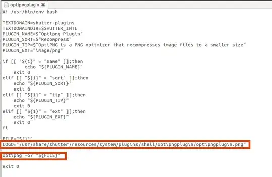

4) Create the script (eg:optipngplugin)
  • gksudo gedit /usr/share/shutter/resources/system/plugins/shell/optipngplugin/optipngplugin
5) Put this content in the script:
#!/usr/bin/env bash
TEXTDOMAIN=shutter-plugins
TEXTDOMAINDIR=$SHUTTER_INTL
PLUGIN_NAME=$"OptiPNG Plugin"
PLUGIN_SORT=$"Recompress"
PLUGIN_TIP=$"OptiPNG is a PNG optimizer that recompresses image files to a smaller size"
PLUGIN_EXT="image/png"
if [[ "${1}" = "name" ]];then
    echo "${PLUGIN_NAME}"
    exit 0
elif [[ "${1}" = "sort" ]];then
    echo "${PLUGIN_SORT}"
    exit 0
elif [[ "${1}" = "tip" ]];then
    echo "${PLUGIN_TIP}"
    exit 0
elif [[ "${1}" = "ext" ]];then
    echo "${PLUGIN_EXT}"
    exit 0
fi
FILE="${1}"
#LOGO="/usr/share/shutter/resources/system/plugins/shell/optipngplugin/optipngplugin.png"
optipng -o7 "${FILE}"
exit 0
In my case I choose the optimization level of OptiPNG to Maximun (-o7) (very slow), and I added an image as a logo.

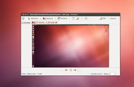

9) Test the plugin. Open shutter and take a screenshot of your desktop.

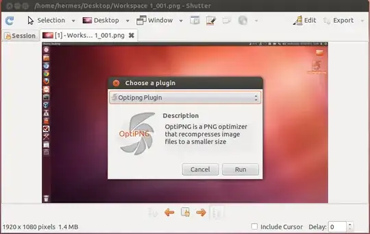

Right click in the screenshot and click in "Run a Plugin...", then choose "OptiPNG Plugin" from the list.

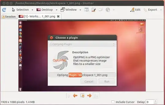

10) Run the plugin to recompress the screenshot you took.
