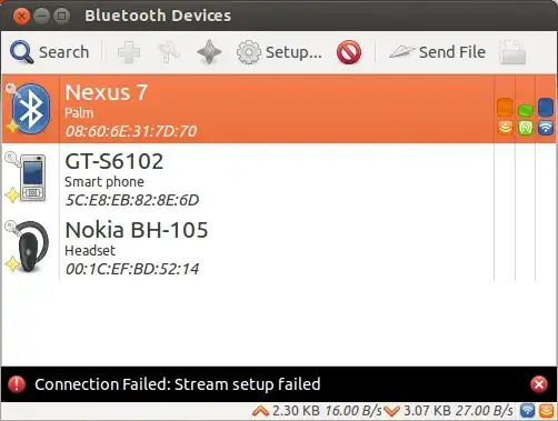

I'm trying to use my PC as a A2DP sink for my Nexus 7, but I can't seem to connect.
The bluetooth dongle I'm using is the ASUS-BT211
Error:Bluetooth
Things that I have tried already:
  • Adding Source to the pulseaudio "Enable" line.
  • Adding Socket to the pulseaudio "Disable" line.
  • Installing all bluetooth packages.
But still, it's not fixed.
Its not an adapter problem. It works fine in windows.

I had a similar problem with my device. I own the bh-905i nokia headset and at first i wasn't even able to pair it, using my bluetooth dongle. This started happening after updating Ubuntu from 12.10 to 13.04 using livecd. My kernel is up-to-date. So: ->The device was detected by blueman, but couldn't pair by any means. ->After adding 'Enable = Socket' to the General section of /etc/bluetooth/audio.conf, i could pair it, but wasn't able to use a2dp stream. The error was "failed to change profile to a2dp". ->the headset appeared on the output tab, but it did not work at all (even though it was paired).
After struggling around a lot, i did this:
sudo alsa force-reload
sudo killall pulseaudio
restarted pulseaudio (alt+F2 pulseaudio)
then i added these lines in /etc/bluetooth/audio.conf
in [General] Disable=Socket
in [Headset] changed HFP value to HFP=false
and in [A2DP] SBCSources=1 and MPEG12Sources=0
then i restarted the bluetooth:
sudo restart bluetooth
and it WORKS now.
Unfortunately, if i disconnect the headset during the session i have to restart alsa and pulseaudio before trying to connect again.
Also, i change the profile to a2dp ONLY on blueman, because if i try to do that at the output tab of the sound manager (alsa, i think), i fail.
Bear with me, please, i am not an expert. And english isn't my first language. good luck!
