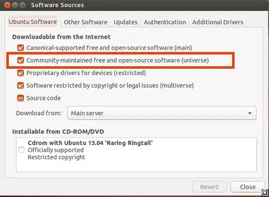

You can try this:
1) Open the "Software Sources" application.
2) Make sure you have enable the "universe" repository, or you should enable it.
3) Close the software source app and open a Termianl and type:
  • sudo apt-get update
  • sudo apt-get install nautilus-open-terminal
The package "nautilus-open-terminal" is in universe repository.
http://packages.ubuntu.com/raring/gnome/nautilus-open-terminal
