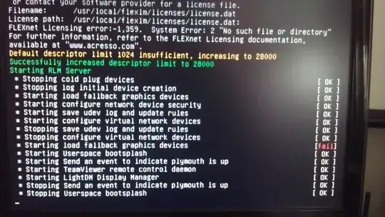

Then i used Update Grub in recovery, it not worked too but i see this line on screen at boot:
at this time it stops and keyboard not working, but when I push the power button it shows these lines and it will shutdown.
OK finally I made it start with older kernel (3.5.0-28-generic). Now how can I keep this kernel or fix Ubuntu to work with new kernel? Should I reinstall Nvidia driver? Which version should I use?
