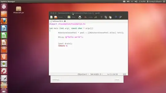

So here I have the basic "hello world" script for Objective-C, I have Ubuntu on my laptop and want to use Ubuntu to start compiling basic ideas, extra classes, or anything worth coding for any of my current projects on the go, so that way I can code a little bit wherever I am and not always have to be on my iMac.
helloworld.m

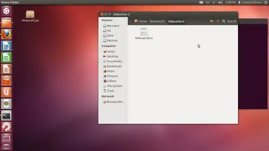

I believe I have all the compiler files installed but I am not opposed to a full tutorial, whatever gets this running. Now to clarify and gather a visual aid for you guys to try and help me better my text file is located in my documents:
filedirectory

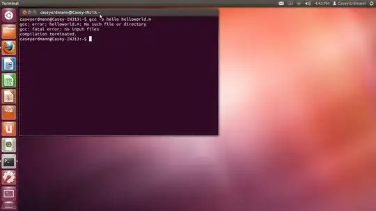

And you can visually see the directory it is placed in. Now when I run any of the commands above that I have tried in terminal it yields this result:
terminal
It doesn't matter which command I use it is always that. I hope this helps a little bit more to provide an answer for my situation. I am not opposed to a full tutorial and having to save my file elsewhere or make any other changes by any means, in fact it'd be appreciated! I just would love to get this running.

You're missing the name for executable file. So, the command should be like:
gcc -o hello helloworld.m
After compilation, type
./hello
-o hello specifies the name of the output file you wish to create once the source is compiled. (In this case the output file name is hello.) This will create an executable file (named hello) which you, then, can run directly from the terminal. If you don't use -o option while compiling, the name of the executable file will be a.out by default. Now to execute that program, you need to type
./hello
