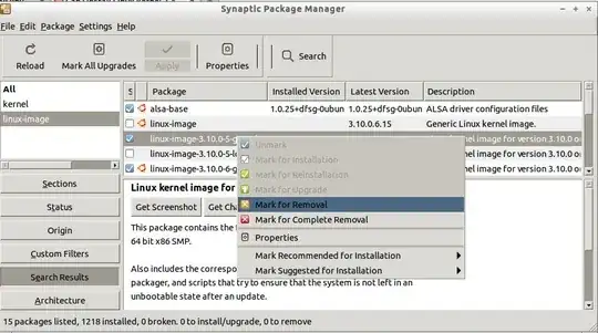

If you used the first option from the answer you indicated, then use synaptic package manager.
First you need to boot from the Original Kernel. If the grub menu does not appear during boot, then hold down Shift key until reveals. From there choose Previous Linux Versions menu (or "advanced options for Ubuntu" if you have a newer version than 12.04) and boot from the Original Ubuntu Kernel.
Then install synaptic package manager. Open a terminal with Ctrl+Alt+t and issue the following command
sudo apt-get install -y synaptic
Find and open synaptic (from Dash just write: synaptic) and search for linux-image-3.4.0 and linux-headers-3.4.0. Right click and mark for removal.
Hit the apply button to remove the kernel and its headers also.
