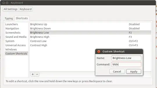

As an exercise for myself, I wrote a short script in order to easily increase and decrease the brightness using xbacklight from terminal. The script is executable (has permission to execute), is an a directory that is included in $PATH in my .bashrc file and is linked to an alias ('blup' to increase and 'bldn' to decrease screen brightness). So, my two aliases (blup/bldn) work perfectly fine from a terminal line. Next, I wanted to link these to some keyboard shortcuts (for instance F2/F3). I did so in 'System Settings --> Keyboard --> Shortcuts --> Custom Shortcuts', but it did not work.
Why?

First of all, aliases are not expanded in non-interactive shells. Read the ALIASES section from man bash in this sense. So, you can't use an alias in 'Command' field when you add/edit a custom shortcut.
Second, as geirha said in this comment, if you changed PATH in .bashrc file, that change will not be available in non-interactive shells. So, you need to change the PATH in ~/.profile file instead.
Third, if you still want to use only bldn in 'Command' field when you add/edit a custom shortcut, you can rename your script with this name and add the script path to the PATH in ~/.profile file, as I said above.
