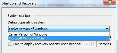

Try this tutorial: Easily Set Default OS in a Windows 7 Dual-boot Setup
In the last step change the dropdown to Windows 7 (there should also be a Ubuntu/Wubi option). You can also change the "Time to display list of operating systems" to '0', or something very short.
Windows 7 image of how to change defauly operating system
