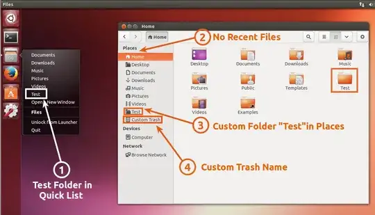

I'm running Ubuntu 13.04 with Nautilus 3.6 and I want to edit the Nautilus Places sidebar menu (Not Bookmarks).
By default have the following items: Recent, Home, Desktop, Documents, Downloads, Music, Pictures, Videos & Trash.
I wish:
  • Add folder to Places (Not Bookmarks).
  • Added Folder must be present in Unity QuickList (Right Click Nautilus icon in Launcher).
  • Remove Recent files (Default in Nautilus 3.6).
  • Rename Trash to another name.
how can I achieve these goals?
NOTE: I tried editing ~/.config/user-dirs.dirs file, but not luck. Is there another way to customize Nautilus Places menu?

In order to achieve that.. you should edit the Nautilus source code and the nautilus.desktop file or using another file manager that allows this, such as nemo.

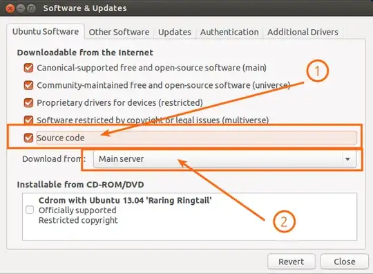

1) Make sure you have enable the Source code repository
  • Open the Ubuntu Software Center
  • In the Menu Bar choose Edit -> Software Sources. Click to enable "Source code repository". Just in case I use the "Main Server" to Download.

Custom Trash: To change the name of the Trash.You can change the strings in the lines 567 and 569.
eg: "Trash" to "Custom Trash" & "Open the trash" to "Open the Custom Trash"

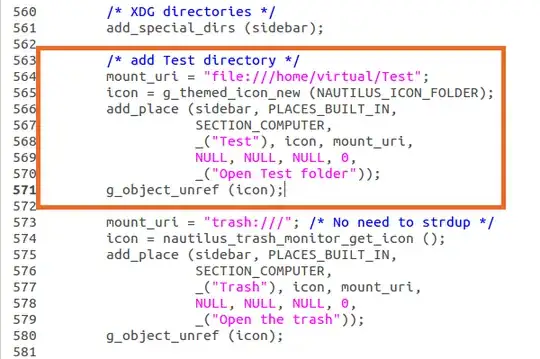

Add Folder: In this example I will add the "Test" folder in my home directory /home/virtual/Test. (change the folder according to your needs)
After the line number 562 add the following:
/* add Test directory */
mount_uri = "file:///home/virtual/Test";
icon = g_themed_icon_new (NAUTILUS_ICON_FOLDER);
add_place (sidebar, PLACES_BUILT_IN,
       SECTION_COMPUTER,
       _("Test"), icon, mount_uri,
       NULL, NULL, NULL, 0,
       _("Open Test folder"));
g_object_unref (icon);

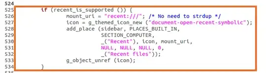

Remove Recent Files: To remove the Recent Files from the places... delete the lines from 525 to 534.
Save the changes.

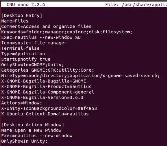

9) For system-wide..edit the nautilus.desktop file to add the folder eg:(/home/virtual/Test) in the quick list.
  • sudo nano /usr/share/applications/nautilus.desktop
Change:
Actions=Window;
To:
Actions=Test;Window;
Add:
[Desktop Action Test]
Name=Test
Exec=nautilus --new-window /home/virtual/Test
OnlyShowIn=Unity;
Before:
After:
10) Finally you can logout and Login to see the changes.
RESULT:
Hope this helps.

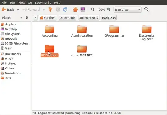

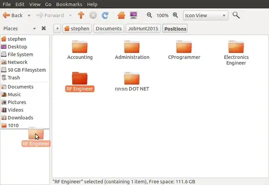

Just drag and drop the files to the bottom left when at a folder! (Nautilus 2.32.0)
I also posted the screenshots at gonorthwork/view for future archive reference:
