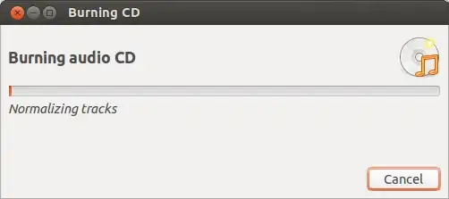

I am trying to burn an audio CD using Brasero. With all albums I've tried to burn, Brasero gets stuck at Normalizing tracks:

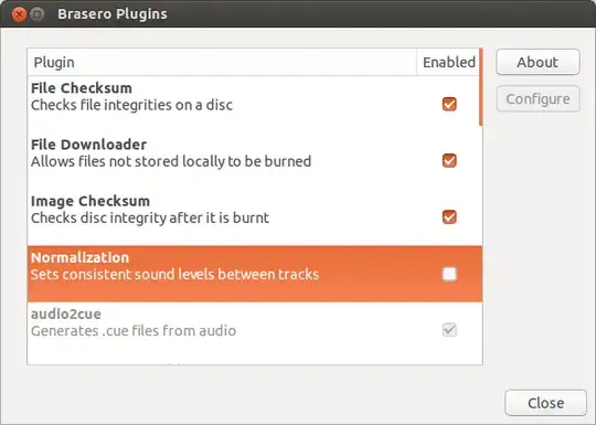

This is a known bug. The workaround for this problem is to disable the normalization plugin.
In Brasero, go to edit and click Plugins. Remove the checkmark for Normalization.
Plugins Window
